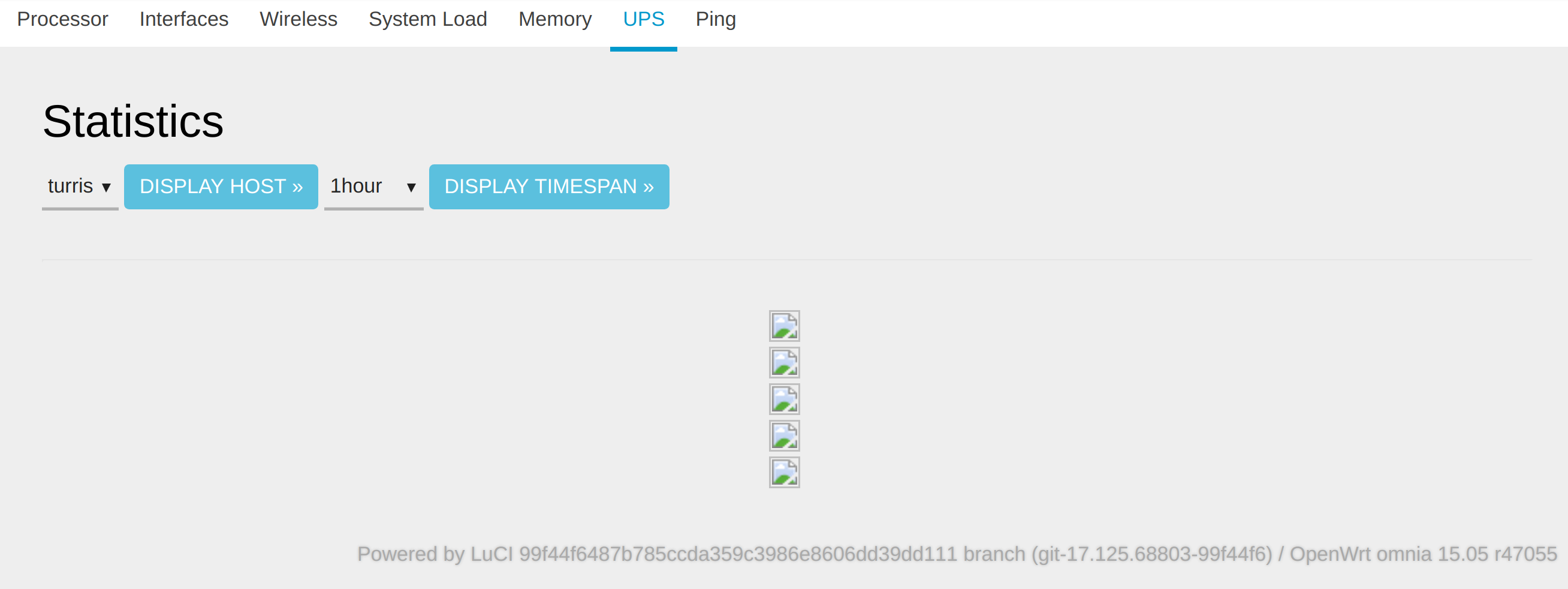

Nut graphs:

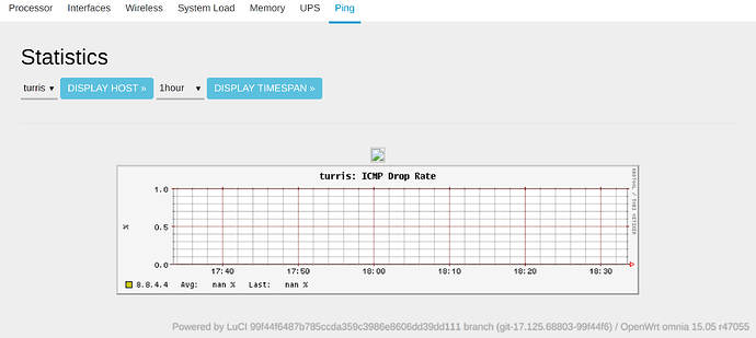

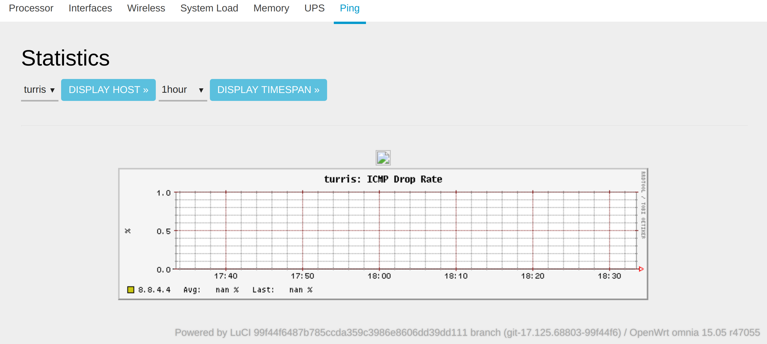

Ping graphs are also buggy:
I found issues with a lot of the collectd stuff packaged from Turris.
If you have other graphs working, I’m not sure why the ping graph isn’t working. It looks like it’s not collecting the data (hence the nan at the bottom). But I also have a broken image graph on top. So, for some reason it isn’t collecting the data.
The graph, however can be easily fixed. Once again, the version of the graph they’re using is broken. If you can find a newer version of /usr/lib/lua/luci/statistics/rrdtool/definitions/ping.lua, perhaps from a different openwrt installation, that should work. If you can’t find one, I copied my version here:

Unfortunately, I don’t use NUT. There doesn’t appear to be any significant difference in the versions of /usr/lib/lua/luci/statistics/rrdtool/definitions/nut.lua that I have. Even if the data collection wasn’t working you should see a bunch of different graphs.

As you figured, using your definitions/ping.lua files fixes the broken image, but still no data of course.
(RRD files are still empty.)
